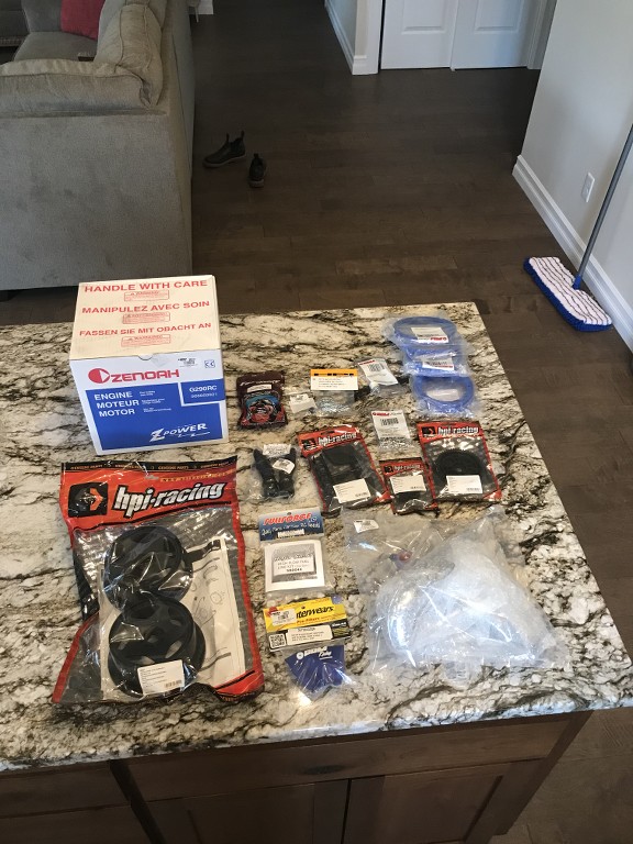

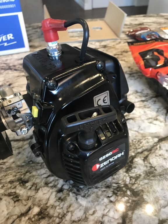

First wave of parts are here! Thanks to DDM for super fast shipping! Quick question about something I didn't think of (I'm sure there will be a lot of this) the new zen290 motor does not have a choke on the carb its built into the platic air-box that I want to swap out for the HPI filter. What do you guys use?
