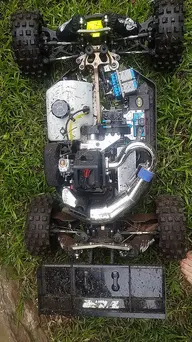

Hey, how is it going? I just finished my build, beside the paint. I was wondering if you've had any run time and had any issues with the pipe being so close to the pull starter?
hi Ralph
few issues as far as the pipe i stripped my motor down few weeks back and the starter is all good. bartalone pipe comes with mounting hard
ware. id did not use it coz made the pipe too high so i made my own
so the pipe has made a small hole in the outerwears cover its smaller than the hole for the pull cord in the outerwears
the glue on tires lasted about 5 minutes:LOL:
totaled my chassis had to replace it(n) center diff sprang a leak(n) body got melted a bit had to trim it round the engine bay and right
at the back. blew up my throttle servo. what i did when i stopped posting here i have this thread and all the good and bad i have posted here https://www.largescaleforums.com/threads/tlr-5b-basher.22700/
Thanks. I'm going to check out that thread. I think I am going to trim the body at the top for the pipe right off the bat. I wonder if there is solution to avoid burning the outerwear on the pull starter too. +1 for the win on cutting the hex for the header, I did the same. I'm probably going to go with some steps though for the batter cover.
I also trimmed the body @ the bottom by the back wheels. The outwears did not melt but rather wore though form the pipe rubbing on it:unsure:. If i was to paint another body id get duct tape and tape on the inside of the body were the body meets the splash guards after the paint job(y). Coz my paint wore off there from rubbing on the splash guards(n)
