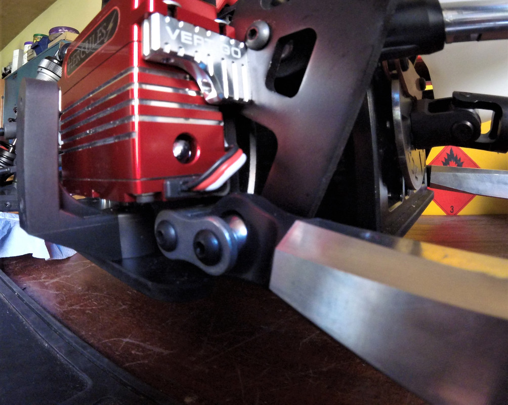

I used heat shrink, I also didn't care for the wires being close to the pivot point on the trailing arm. I've had no issues.
thanks portcity (y)(y),
i'm obsessed about trapped wires thats all :LOL:, always takes me forever to sort the wiring side of things out, i'm never happy with how i run it🤦‍♂️ :ROFLMAO:,
thanks for the reply mate,
I totally agree I don't like the wiring position. It bothered me a lot, but I love how the hilantronics has been performing. Very quiet and not a glitch whatsoever. When I shrink wrapped I used smaller tubing so the casing became very hard so I set everything into position then shrink wrapped it so it stays right in place. So far so good. And your welcome brother!👍. She's coming along very nicely. Good things take time👍😎🤘
good to see the hilantronics are all behaving with everyone (y)(y),

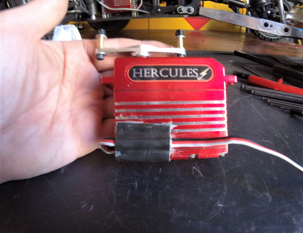

right so this is what i've done :), likesean did, up and behind the servo,
taped mine part way along and then run it through the side plate, also taped the side plate where the wire runs close,
so now it clears the pivot and still has an air gap between the wire and the side plate(y),

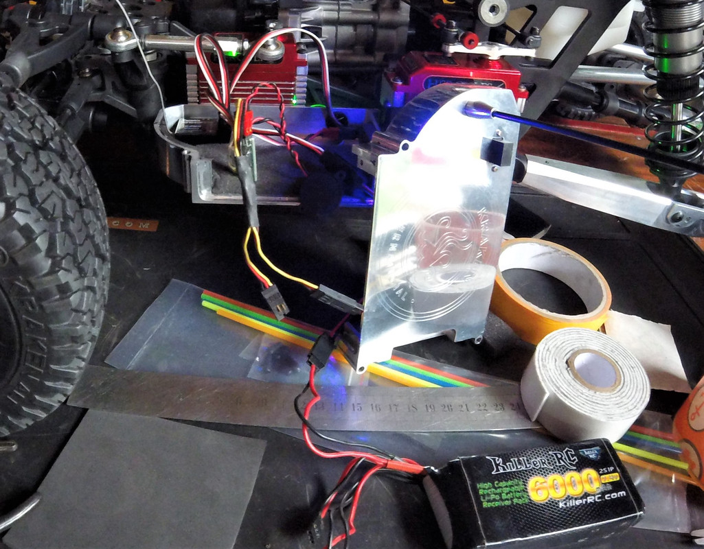

working out the rest of it now, where to put what and where to add foam etc :LOL:,

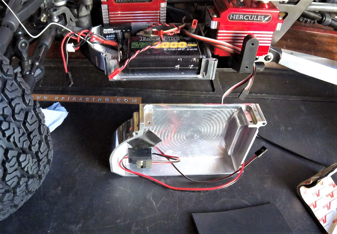

glued some foam down in the bottom of the haric box, double sided taped the rx in like this below,

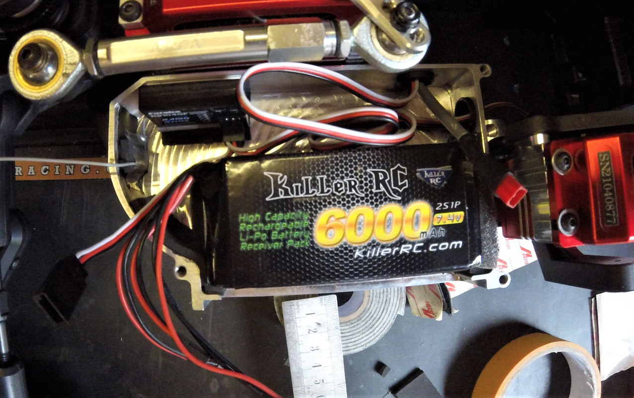

saw how tight the servo plugs were up against the battery,

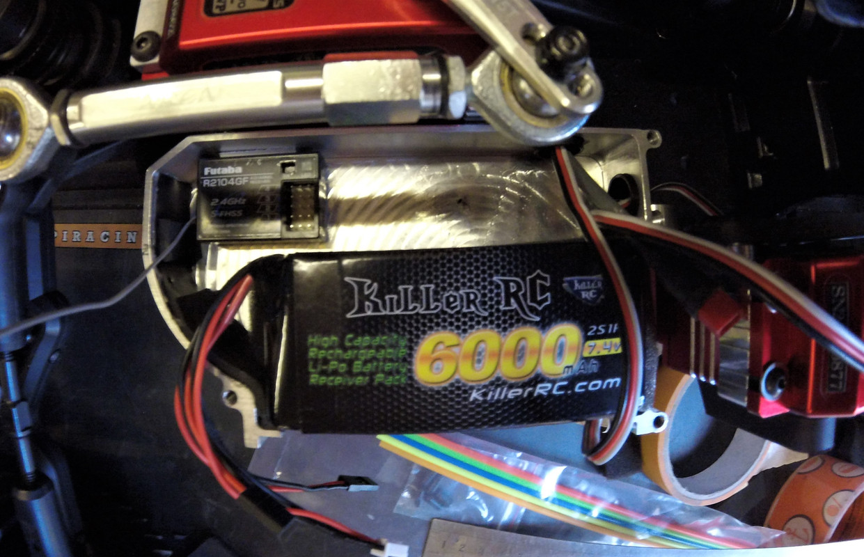

so changed the rx to like this below,
gives a tad more room and it wont be squishing the servo wires and kill switch plug etc (y),
then had a final connect up and check after i decided what was going in there,
extensions etc, also swapped the kill wire to come in from the rear instead of the side cos that gives more wiggle room an all (y),
